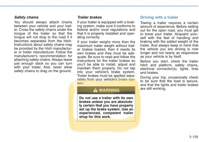

Are you certain this does not void the warranty? Having spoken to the Hyundai sales guy he said that modifications may void the warranty.

This is a screenshot from the Palisade manual. Hyundai recommends to take it to a brake shop for any kind of towing where you need to activate a trailer’s own brake system. Basically you would need a 7-pin setup for external brakes, so if there are any issues with warranty issues down the road I can present this page of the manual along with my receipt of the warranty work done at the trailer shop to show I had it done by a professional. Honestly I’m not sure if the sales guy knows that this is a required upgrade, not modification in order to tow legally in most states.hope this helps!

If you reference post #44 on this thread, there’s an excerpt from the manual stating to have a professional trailer shop do the brake line (7-pin) from the Hyundai owners manual.
This would ensure that you were not voiding the warranty

Thanks for the reply, I saw that post as well. However, my concern is that an excerpt from the manual that refers to a shop does not necessarily imply that the warranty will not be effected. It does not specifically mention the warranty and Hyundai could potentially not honor it based on a number of things as often happens when you "modify" your car in the after-market. In fact, I was told by my Hyundai dealer (and I quote): "If an issue arises due to something that was done after market... the issue wouldn't be covered under warranty. However, if something happens and it's deemed to not be the fault of anything after market... You'll be fine." So I have my concerns.

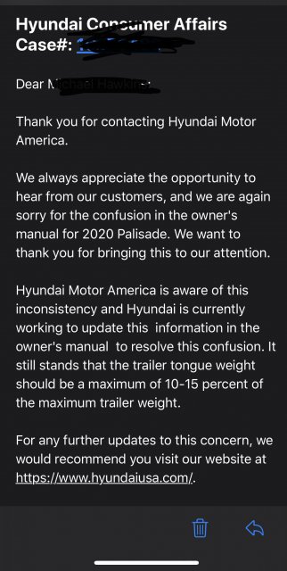

More good news on the tongue weight update: Received an email from Hyundai corporate, and they are aware of the confusion and are working to update the manual. They are stating that you can tow 10-15% of your trailer tongue weight when towing, see email below:
