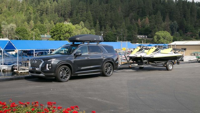

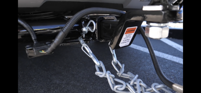

Hello @Mikeg112 , thanks for the pictures.
Your trailer its 4k pounds dry weight or GVRS?
Thank you!
View attachment 845 View attachment 846 View attachment 847
After renting a truck for past six months so happy to finally have a tow vehicle that can handle our 4,000 trailer. Took it for a brief test drive last night, here’s my initial feedback:
The palisade did sag a bit initially once you hitch up. But the self-leveling takes about 3-4 miles to adjust due to the nature of the self-leveling shocks. I probably have about a 1-inch drop in the rear axle, will drive an hour to our camping spot and see if I need a weight distribution/sway control hitch over the weekend.
Drive: as a driver you do notice you’re towing, but leaving in comfort mode it almost auto-adjusts the rpms to match the uphill and towing. Surprisingly my wife in the passenger seat didn’t even notice that we were towing! I tried sport mode but was revving a little too high for my preference, so I leave in smart mode for now.

Ditto on it being factory installation. I had already purchased the factory tow hitch and wiring harness from the dealer for about $580 total. I have an appointment this Tuesday to have it installed along with a 7-pin controller harness and P3 Tekonsha brake controller. They need to run power and from the battery and brake wire to brand new 7-pin adaptor. The factory only comes with a 4-pin.
So I bought a 2021 Palisade with the Factory Tow Package and Hitch - Supposed to be good for 5000lbs. But like you said, it only has the 4 Prong Plug. So does this mean I have to get the Dealer to Install 7-pin controller harness and P3 Tekonsha brake controller before I can pull my Trailer?
Sjgolub
Washington D.C., DC, USA
2021 Palisade
#67
After some research I decided to go the DIY route. Ordered the same Curt hitch that Hyundai sells for about $100 cheaper. The wiring, 7 pin plug, brake controller (went with the Redarc Tow Pro Elite because it has an incredibly small dashboard footprint) were all available thru eTrailer.com. Would have been easier with a lift but it can be done without one.
