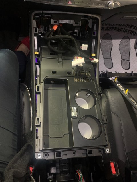

Yes I will try whatever and do not mind being the guinea pig for future people. I will document it too as needed too. The shop is putting everything back together and charging me four hours labor :rolleyes:, but I don't mind tearing things apart myself.

The best I found was for a max cruz, which is the santa fe xl. Would you like to do some trial and error? Worst case would be a blown fuse.
actually, let me ask some people I know in Korea. Ill get back to you soon.
I am willing to try anything and will document whatever for future people wanting to add this.

the dealers tech should be able to down load the wiring diagram from https://www.hyundaitechinfo.com/ for you.
If he agrees to download the wiring for you have him down load the wiring for your rear light also
I actually paid for this and have that info, but nothing was helpful to the dealer. I am not sure if I just happened across a tech that doesn't experiment or clueless. I can put that info up here but I am not sure if that actually helps since these items were not in the original wiring and require wire taps or splicing. Knowing what wires to tap in to is the crucial part that is missing. If I am incorrect in this statement by all means please let me know.

Do you know which wires on the cooler/heater are ground and + wires?
If you have the wiring diagram and post it on here. Someone may be able to help
Maybe take a picture of the wires for the cooler/heater

That is the problem I have been struggling with everything that came with this was in Korean and with the help of others it was determined that this was only operational instructions not installation instructions. I do have access to the HyundaiTechInfo site for another 15+ days, but I am not sure what there can help me.

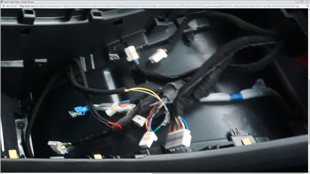

Ok, it seems like there are 4 wires that need to be spliced into. According to the other installation guides I read for different hyundai vehicles.
http://www.tuixmall.com/info/installationview.do?type=car_shop&pk=59 Maxcruz
http://www.tuixmall.com/info/installationview.do?type=car_shop&pk=60 Tucson
These two seem to be just plug and play. But a little more info, one should be a 12pin connector that connects to the PRNG gear connector, which would show the led lights for the cup holder.
Let me draw up a wiring diagram in a bit.
EDIT - Good news. I find some kakaotalk contact info for hyundai mobis. I'll send them a message and request the installation guide.

Thanks for your help on this, if you need access to the https://www.hyundaitechinfo.com/ let me know and I will give you my login.
#31
Black is usually a standard negative wire and the red is the 12 volt plus side of power.
Not sure what the yellow and white are for.

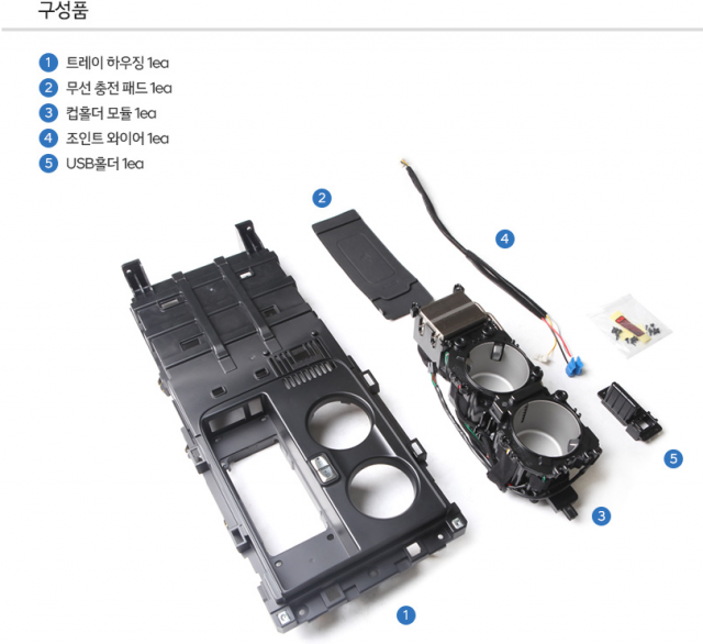

Are you sure this will fit in the Palisade?
biggest problem looks like where are you going to put vents to dissipate the heat.
You will notice they have made cutouts for a vent cover.
Yes this is specifically made for the palisade and eliminates the console from closing with this addition. http://www.tuixmall.com/product/view.do?pid=16270&pcid=3636

Hard to tell what the white and yellow wires are to . Does the unit have mood lamps inside? the two wires almost look like plug and play.
