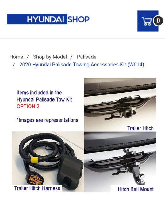

Can anyone confirm the official Hyundai Palisade hitch? On the www.hyundaishop.com website they show this:
But it's stated that the image is a representation. Then I saw this on the www.kiatelluride.org site:

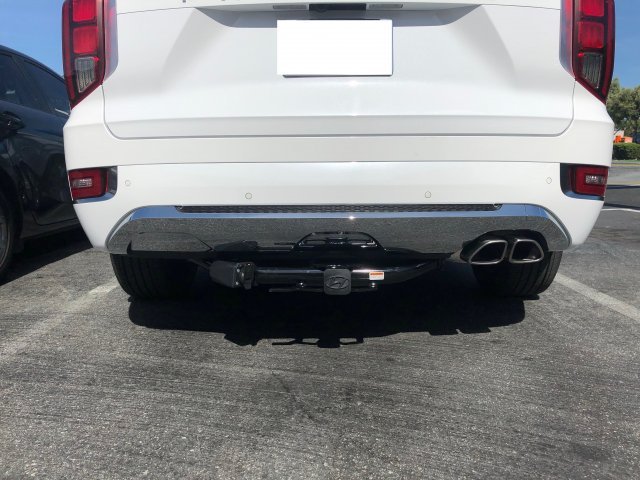

I dont like the exposed crossbar look. I've also looked for aftermarket options and was unsuccessful. Are we all or for those who plan on towing stuck with the exposed crossbar.
St. Pete Beach, FL, USA
The one showing is the Hyundai solution, and is exposed. I understand the comment on the Stealth solution, but so far the only hidden one I've seen. Hopefully other makers will come to market quickly. I will note, from what I've read a loaded motorcycle carrier could be pushing tong weight unless it is for a scooter etc. Good luck

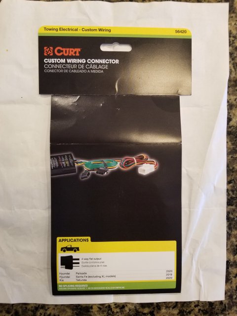

Could not find anyone to just install a hitch (my kids don't live close !). Had to go to U-Haul. They have the Curt for $204, install for $64. Not many U-Haul places will let you wait while they do the job these days either. Primary need is for my bike carrier, if I ever need wiring will do myself.

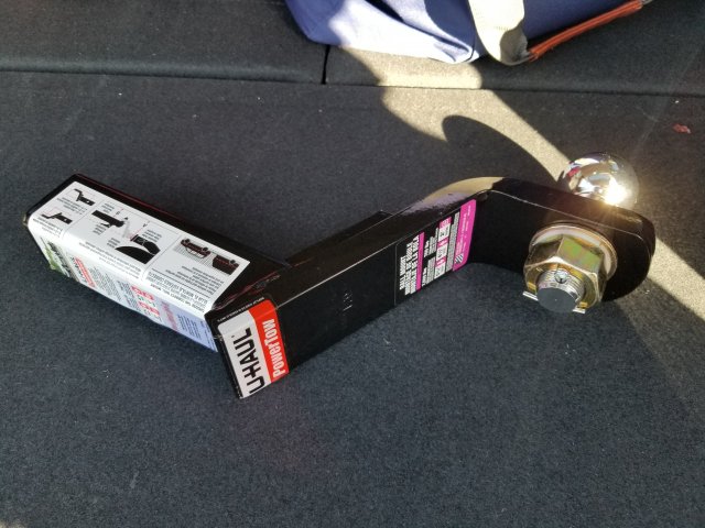

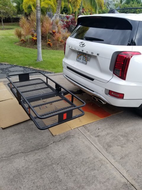

Just installed the $205 UHaul version. Checked the 4-Flat wire at UHaul when I picked up the hitch and ball yesterday. Ends up at about 18" for common utility trailers they rent. Will use mostly for cargo rack to the landfill. I consider the exposed 2" reciever as a exhaust tip drag protector 😜.

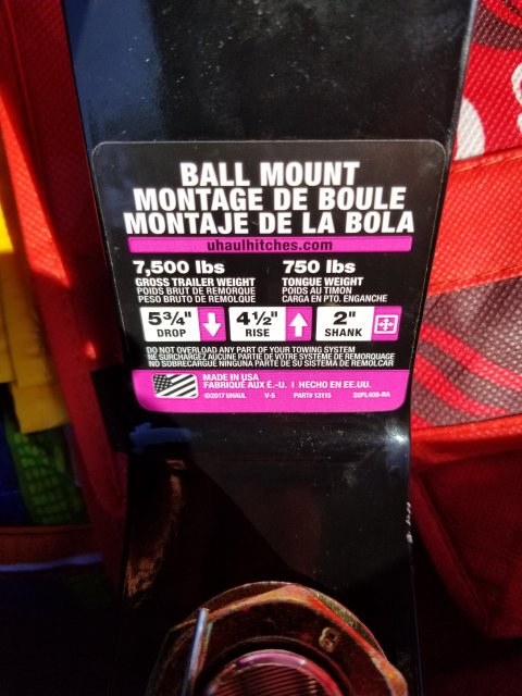

BTW, hitch is 5000#/750# tongue without Weight Distribution hitch, 6000#/750# with Weight Distribution. The 5.5" rise hitch is 7000#/750# rated. Pretty sure I'll not be getting anywhere near that on island. 🤓
