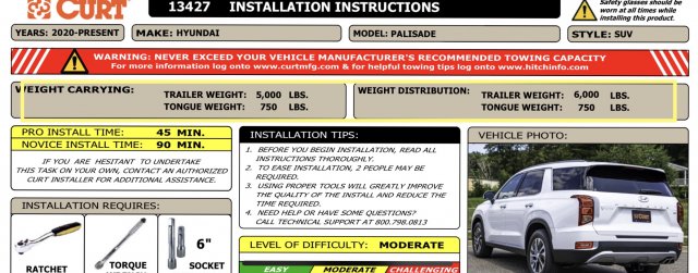

FWIW I purchased the OEM hitch (including the tow bar & pin, but no harness) from hyundaiaccessorystore.com. With the new-customer incentive it came out to $308 shipped. I bought the harness from a seller on ebay, it's a Tekonsha 118784, cost me $43 delivered (including Virginia tax, which eBay now collects). I'm certain it's the same harness as OEM.
The OEM hitch is manufactured by Curt, but is not exactly the same as their newly-released aftermarket unit (p/n 13427). The Hyundai OEM one includes an additional bracket for holding the 4-pin harness plug securely next to the receiver.
The curt instructions are available here: https://assets.curtmfg.com/masterlibrary/13427/installsheet/CM_13427_INS.PDF
In addition, the OEM hitch includes a mix of metric and standard hardware, whereas the aftermarket version is all metric. Same basic mounting points though.
I'd bet the aftermarket hitch will soon be available for close to $200 so you can definitely save some cash over OEM if you want. I like the extra bracket, makes for a tidier installation and usage, but everybody will have their own thought on whether that's worth $100...

Assuming the pictures of the Hyundai hitch and the curt are correct, they are designed a little differently. The Hyundai looks to drop the entire bar down all the way below the number starting right from the mounts. The Curt looks to drop the bar a lesser amount, and then has a drop of a couple of inches right at the receiver box. If it looks as it seems, the Curt may not be as visible below the back of the car, with mainly the receiver box showing. I have mine on order for delivery early next week, interested to see how it fits and if the photos of both hitched are true.

That's a very good point and I think you're quite right. The oem primary tube includes the vertical drop dimension whereas the curt aftermarket achieves the drop with the welded plate steel brackets.
There also look to be some small dimensional differences in the right angle plates which cradle the two frame rails on either side. Both hitches use all the same mounting points however.
