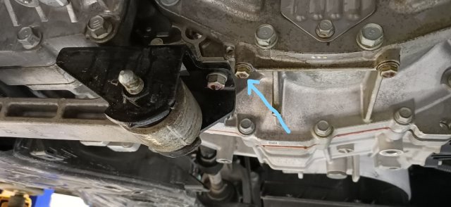

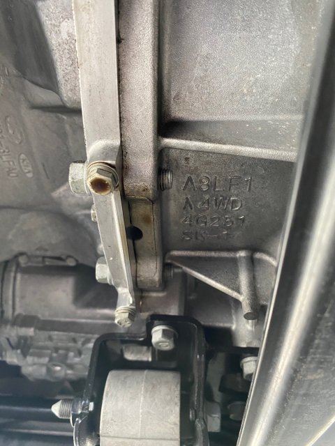

Finally, found a drop of oil on the bolt shown with a blue arrow, and the other picture just like it shows there, but with no trace where it came from (they're not my pictures, I may add). And my oil was still clear, since it only had 504 miles. Found several more cases of bad crankshaft seals besides those 2, and I'm afraid that's exactly what's happening to mine :(. Didn't see evidence of the leak, but cleaned everything perfectly, including removing that bolt (no oil in there), so will check it again after my trip, to see if by any chance it was oil from somewhere else, but after several instances of bad seals, I really doubt it. Will report on what I find soon.
