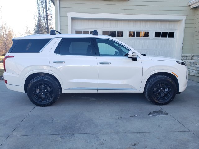

I put a 2 inch "lift" (leveling kit) on my Palisade and now it rides high in the front. I think the self-leveling got messed up somehow when I did it. Anyone have any idea how to adjust it to be higher on back so it is level again? It doesn't look like much in the picture, but it is enough that oncoming cars flash me as if I had my brights on.

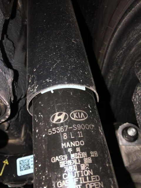

Are the factory self-leveling parts installable as an after-sales accessory?
Like, is there a part number for the kit that we can buy and install after purchase?
Elp_jc
El Paso, TX, USA
2021 Palisade Calligraphy FWD
The Palis don't have the typical self-leveling suspension; it has self-leveling SHOCKS only. And they're not adjustable. You'd have to buy different ones for the height you need, and good luck with that :).

Not sure what lift kit you used, but looks like it was lifted higher in front than in back.
Does the kit use the OEM self leveling shocks? they are not adjustable.
